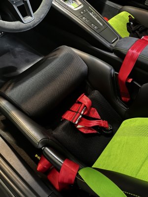

Quick update on my project: I’ve asked Porsche to reinstall my factory seats while retaining the Manthey roll cage. Once I get the car back, the first thing I’ll try is removing the seat cushion bottoms from my Lightweight Buckets (LWBs) to see if that improves headroom.
If that helps with clearance, the next step will be developing a custom seat cushion setup for track use—something that offers better leg support along with added comfort for my lower back and buttocks.
I’ll also be taking a close look at the OEM LWB seat sliders. My goal is to either:
a) Design a fixed-position mounting solution that lowers the OEM LWD seat, or
b) Ideally, engineer a new system that lowers the seat while still allowing forward/backward adjustment.
The car returns from the dealership on June 2, 2025, and that’s when I’ll begin the engineering work in earnest.

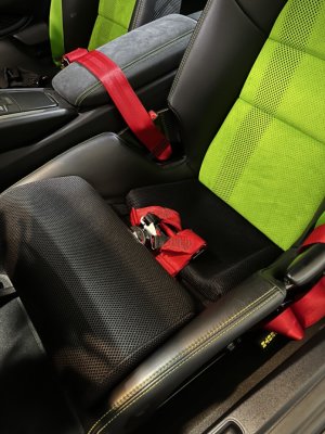

Update – June 2, 2025
WOW! Removing the seat cushion from the Lightweight Buckets gave me plenty of headroom with my helmet on—an expensive lesson learned.
Next step: I need to develop a low-profile seat cushion that still offers solid leg support and improved comfort for my lower back and buttocks, while maintaining this newfound head clearance.
I’ll also continue exploring ways to lower the OEM LWB seat. That said, the electronic modules mounted underneath are very close to the floor—so relocation may be necessary if I go that route.
Engineering work begins now. More updates soon!
